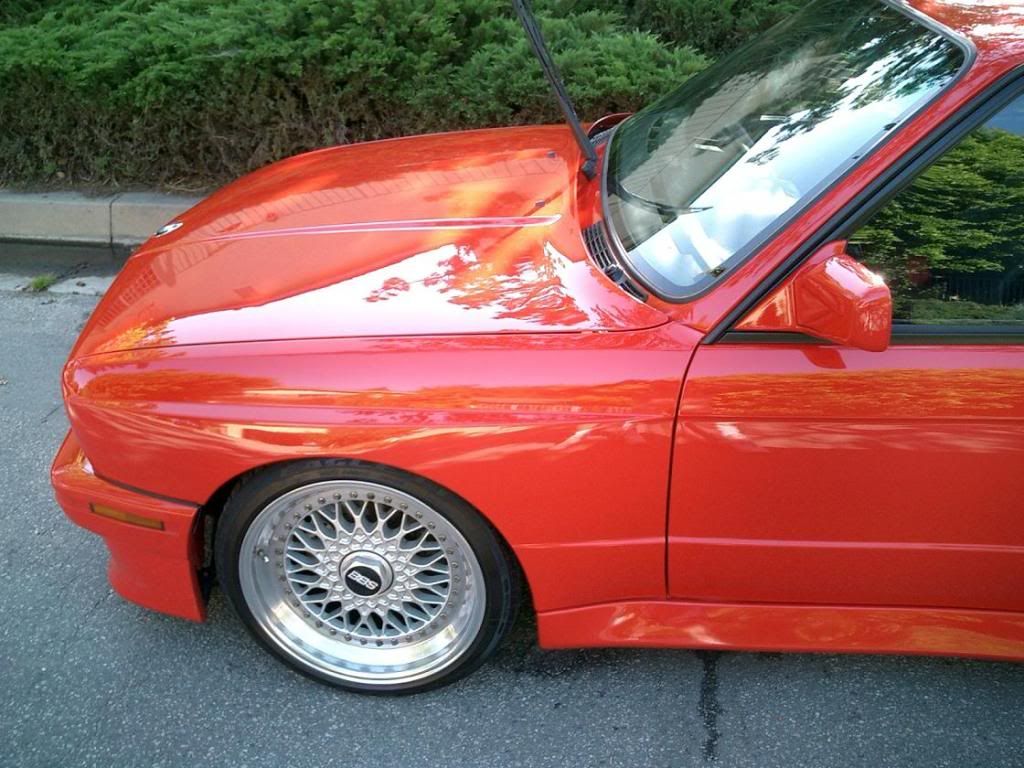

Message With a smooth outer lip the drop center of the wheel is on the inner half (the step is on the back side) and the tire is mounted from that side.
I like both styles but each has it's place.
This E30 would look strange with a reverse mount wheel IMO.
Standard mount wheels are almost always seen on racecars.
I normally prefer reverse mount on most street cars.
